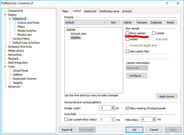

Читал тему и помню был разговор по громадным диалогам jscript panel последних верисий, эта проблема очень легко решается resource hacker-ом.
У себя привел диалоги к такому виду...
Изображение Изображение
Это скрипты диалогов Properties и Редактора скриптов для resource hacker-а, возможно будут полезны.
//===================== Script Editor Dialog Sizes
102 DIALOGEX 0, 0, 420, 132
STYLE WS_MAXIMIZEBOX | WS_POPUP | WS_CAPTION | WS_SYSMENU | WS_THICKFRAME
CAPTION "JScript Panel Configuration"
LANGUAGE LANG_ENGLISH, SUBLANG_ENGLISH_US
FONT 8, "Tahoma", FW_NORMAL, FALSE, 0
   CONTROL "", 1000, EDIT, ES_CENTER | ES_READONLY | WS_CHILD | WS_VISIBLE | WS_BORDER, 7, 5, 404, 14
   CONTROL "", 1001, "JScriptScintilla", 0x52000000, 7, 23, 404, 79
   CONTROL "&Tools", 1002, BUTTON, BS_PUSHBUTTON | WS_CHILD | WS_VISIBLE | WS_TABSTOP, 7, 110, 50, 14
   CONTROL "Script Engine:", 1003, STATIC, SS_RIGHT | WS_CHILD | WS_VISIBLE | WS_GROUP, 63, 102, 50, 8
   CONTROL "", 1004, COMBOBOX, CBS_DROPDOWNLIST | WS_CHILD | WS_VISIBLE | WS_VSCROLL | WS_TABSTOP, 63, 112, 55, 21
   CONTROL "Edge Style:", 1005, STATIC, SS_RIGHT | WS_CHILD | WS_VISIBLE | WS_GROUP, 123, 102, 45, 8
   CONTROL "", 1006, COMBOBOX, CBS_DROPDOWNLIST | WS_CHILD | WS_VISIBLE | WS_VSCROLL | WS_TABSTOP, 123, 112, 55, 21
   CONTROL "Transp", 1007, BUTTON, BS_AUTOCHECKBOX | WS_CHILD | WS_VISIBLE | WS_TABSTOP, 187, 105, 35, 10
   CONTROL "&Grab Focus", 1008, BUTTON, BS_AUTOCHECKBOX | WS_CHILD | WS_VISIBLE | WS_TABSTOP, 187, 120, 52, 10
   CONTROL "&OK", 1, BUTTON, BS_DEFPUSHBUTTON | WS_CHILD | WS_VISIBLE | WS_TABSTOP, 250, 110, 50, 14
   CONTROL "&Apply", 110, BUTTON, BS_PUSHBUTTON | WS_CHILD | WS_VISIBLE | WS_TABSTOP, 306, 110, 50, 14
   CONTROL "&Cancel", 2, BUTTON, BS_PUSHBUTTON | WS_CHILD | WS_VISIBLE | WS_TABSTOP, 362, 110, 50, 14
//===================== Properties Dialog Sizes
109 DIALOGEX 0, 0, 350, 215
CAPTION "JS Properties"
FONT 9, "Tahoma", FW_NORMAL, FALSE, 1
   CONTROL "", 1014, LISTBOX, LBS_NOTIFY | LBS_OWNERDRAWVARIABLE | LBS_NOINTEGRALHEIGHT | WS_CHILD | WS_VISIBLE | WS_BORDER | WS_VSCROLL, 7, 3, 335, 190
   CONTROL "De&lete", 1010, BUTTON, BS_PUSHBUTTON | WS_CHILD | WS_VISIBLE | WS_TABSTOP, 7, 198, 40, 14
   CONTROL "C&lear", 1011, BUTTON, BS_PUSHBUTTON | WS_CHILD | WS_VISIBLE | WS_TABSTOP, 50, 198, 40, 14
   CONTROL "I&mport", 1012, BUTTON, BS_PUSHBUTTON | WS_CHILD | WS_VISIBLE | WS_TABSTOP, 93, 198, 40, 14
   CONTROL "E&xport", 1013, BUTTON, BS_PUSHBUTTON | WS_CHILD | WS_VISIBLE | WS_TABSTOP, 136, 198, 40, 14
   CONTROL "&OK", 1, BUTTON, BS_DEFPUSHBUTTON | WS_CHILD | WS_VISIBLE | WS_TABSTOP, 190, 198, 45, 14
   CONTROL "&Apply", 110, BUTTON, BS_PUSHBUTTON | WS_CHILD | WS_VISIBLE | WS_TABSTOP, 244, 198, 45, 14
   CONTROL "&Cancel", 2, BUTTON, BS_PUSHBUTTON | WS_CHILD | WS_VISIBLE | WS_TABSTOP, 298, 198, 45, 14
Последний раз редактировалось duzzy 16.05.2018, 21:55, всего редактировалось 1 раз.

Такой вопрос. Как вернуть рамку к панели? Если она пустая, то пкм спасает, а если не ней висит скрипт, то блин не могу догадаться.
