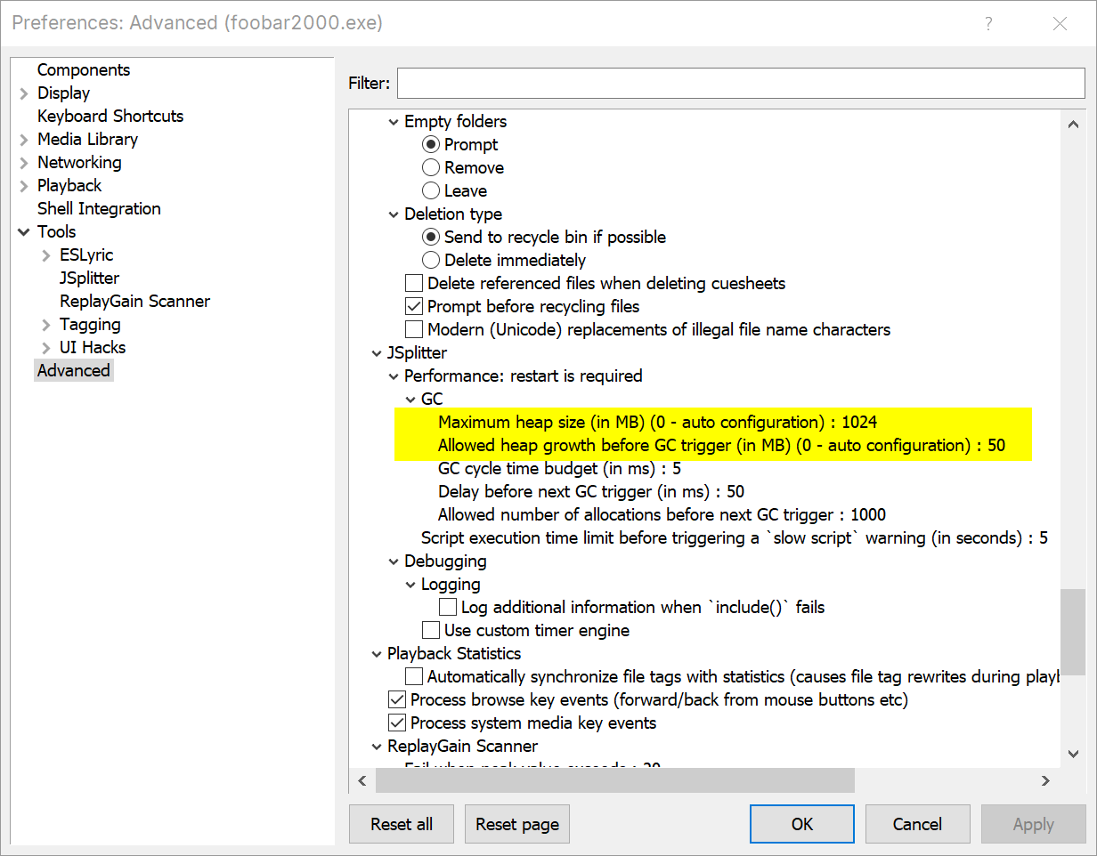

Сообщение #422 LUR » 13.02.2025, 09:35
regor:some changes to current features (which hopefully should be easy to implement), like the limit of heap size at advanced preferences.
SpiderMonkey API has a limit for context memory:
// Create a new context (and runtime) for this thread.
extern JS_PUBLIC_API JSContext* JS_NewContext(uint32_t maxbytes, JSRuntime* parentRuntime = nullptr);
But I can increase the limit for the garbage collection threshold (now it is 256MB).

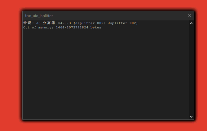

Hi LUR, due to default setting of JSPlitter memory limit, when initially caching the covers of a big library, e.g. 60K+ tracks, it will easily reach the limit and result in crash.
Could you consider increase the default settings or set it to 0 (auto)? (I change to 0 and no crash occurred).
