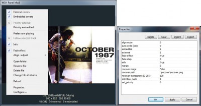

maklaud, :beer:
Get Covers (Artwork)
version "06052016"
// ==PREPROCESSOR==
// @author "kgena_ua"
// @version "06052016"
// @feature "v1.4"
// @feature "watch-metadb"
// ==/PREPROCESSOR==

    MF_ENABLED = 0x00000000;
    MF_GRAYED = 0x00000001;
    MF_SEPARATOR = 0x00000800;
    _menu.AppendMenuItem(MF_ENABLED, 10, "External covers");
    _menu.CheckMenuItem(10, set_external);
    _menu.AppendMenuItem(MF_ENABLED, 11, "Embedded covers");
    _menu.CheckMenuItem(11, set_embedded);
    _menu.AppendMenuItem(MF_ENABLED, 20, "Priority external");
    _menu.AppendMenuItem(MF_ENABLED, 21, "Priority embedded");
    _menu.CheckMenuRadioItem(20, 21 , set_priority + 20);
   _menu.EnableMenuItem(set_priority + 20, 1);
    _menu.AppendMenuItem(MF_ENABLED, 30, "Prefer now playing");
    _menu.AppendMenuItem(MF_ENABLED, 31, "Follow selected track");
    _menu.CheckMenuRadioItem(30, 31 , selection_mode + 30);
   _menu.EnableMenuItem(selection_mode + 30, 1);
    _menu.AppendMenuItem(MF_ENABLED, 40, "Info");
    _menu.CheckMenuItem(40, info);
    _firstgroup.AppendTo(_menu, MF_ENABLED, "Align : " + align_mode_a[align_mode]);
    _firstgroup.AppendMenuItem(MF_ENABLED, 60, align_mode_a[0]);
    _firstgroup.AppendMenuItem(MF_ENABLED, 61, align_mode_a[1]);
    _firstgroup.AppendMenuItem(MF_ENABLED, 62, align_mode_a[2]);
    _firstgroup.AppendMenuItem(MF_ENABLED, 63, align_mode_a[3]);
    _firstgroup.AppendMenuItem(MF_ENABLED, 64, align_mode_a[4]);
    _firstgroup.AppendMenuItem(MF_ENABLED, 65, align_mode_a[5]);
    _firstgroup.CheckMenuRadioItem(60, 65, align_mode + 60);
    _firstgroup.EnableMenuItem(align_mode + 60, 1);
    var MF_ = covers[covernumber] && typeof covers[covernumber] != 'object' ? MF_ENABLED : MF_GRAYED;
    _menu.AppendMenuItem(MF_, 70, "Open folder");
    _menu.AppendMenuItem(MF_, 71, "Rename file");
    _menu.AppendMenuItem(MF_, 72, "Delete file");
    _menu.AppendMenuItem(MF_, 73, "Change file attributes");
    //_menu.AppendMenuItem(MF_ENABLED, 100, "Reload");
    switch (ret) {
    case 10:
        set_external = set_external == 0 ? 1 : set_embedded == 0 ? 1 : 0;
        get_covers();
    case 11:
        set_embedded = set_embedded == 0 ? 1 : set_external == 0 ? 1 : 0;                ;
        window.GetProperty("embedded", set_embedded);
        get_covers();
    case 20:
        set_priority = 0;
        get_covers();
    case 21:
        set_priority = 1;
        get_covers();
    case 30:
        selection_mode = 0;
        on_item_focus_change();
    case 31:
        selection_mode = 1;
    case 40:
    case 50:
    case 60:
    case 61:
    case 62:
    case 63:
    case 64:
    case 65:
        align_mode = ret - 60;
    case 70:
    case 71:
        file_operation = true;
        change_filename();
    case 72:
        delete_file();
    case 73:
        change_file_attributes();
    case 100:
        //window.Reload();
    case 110:
        window.ShowProperties();
    case 120:
        window.ShowConfigure();
    _menu.Dispose();
    return true;

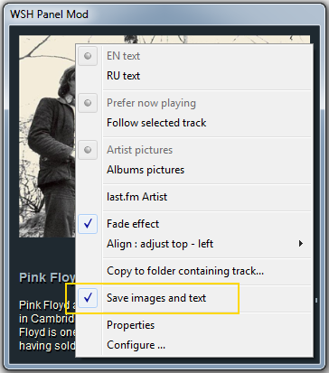

Сообщение #1010 kgena_ua » 14.05.2016, 12:16
Biography Text && Picture. www.last.fm
version "14052016"
Добавлена возможность сохранения текста.
    _menu.AppendMenuItem(MF_ENABLED, 10, "EN text");
    _menu.AppendMenuItem(MF_ENABLED, 11, "RU text");
    _menu.CheckMenuRadioItem(10, 11, abc + 10);
    _menu.EnableMenuItem(abc + 10, 1);
    _menu.AppendMenuItem(MF_ENABLED, 12, "Prefer now playing");
    _menu.AppendMenuItem(MF_ENABLED, 13, "Follow selected track");
    _menu.CheckMenuRadioItem(12, 13 , selection_mode + 12);
   _menu.EnableMenuItem(selection_mode + 12, 1);
    _menu.AppendMenuItem(MF_ENABLED, 14, "Artist pictures");
    _menu.AppendMenuItem(MF_ENABLED, 15, "Albums pictures");
    _menu.CheckMenuRadioItem(14, 15 , select_p_a + 14);
   _menu.EnableMenuItem(select_p_a + 14, 1);
    var is_artist = artist ? MF_ENABLED : MF_GRAYED;
    _menu.AppendMenuItem(is_artist, 16, "last.fm Artist");
    _menu.AppendMenuItem(MF_ENABLED, 17, "Fade effect");
    _menu.CheckMenuItem(17, fade_effect);
    _firstgroup.AppendMenuItem(MF_ENABLED, 20, align_mode_a[0]);
    _firstgroup.AppendMenuItem(MF_ENABLED, 21, align_mode_a[1]);
    _firstgroup.AppendMenuItem(MF_ENABLED, 22, align_mode_a[2]);
    _firstgroup.AppendMenuItem(MF_ENABLED, 23, align_mode_a[3]);
    _firstgroup.AppendMenuItem(MF_ENABLED, 24, align_mode_a[4]);
    _firstgroup.AppendMenuItem(MF_ENABLED, 25, align_mode_a[5]);
    _firstgroup.CheckMenuRadioItem(20, 25, align_mode + 20);
    _firstgroup.EnableMenuItem(align_mode + 20, 1);
    var MF_ = images.length > 0 ? MF_ENABLED : MF_GRAYED;
    _menu.AppendMenuItem(MF_, 30, "Copy to folder containing track...");
    _menu.AppendMenuItem(MF_ENABLED, 40, "Save images and text");
    _menu.CheckMenuItem(40, save_images);
