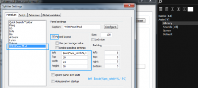

musikomaniak, you must

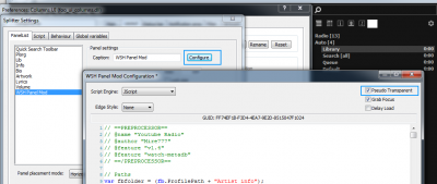

insert WSH panel
configure panel

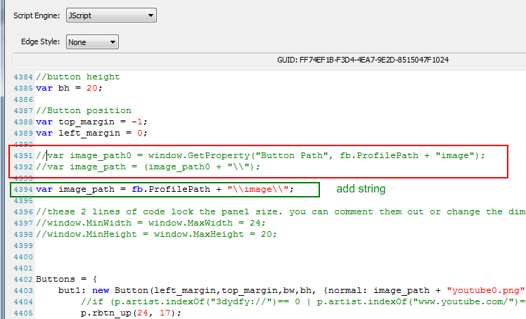

place *.png into ..../foobar200/image/ (or change path in the scrip....)
insert script into WSH panel

I did exactly (I think) what you showed, with left:
$sub(%ps_height%, 170)
Why I do not have the same result as you? I installed a new portable foobar.
If I check "Forced Layout", the image disappear.

musikomaniak, need change script like below

Сообщение #277 musikomaniak » 04.04.2014, 10:39
Yesss!!!!! :beer:
I hope vladj and Lur will read your solution.
Thank you very very much :smile:
