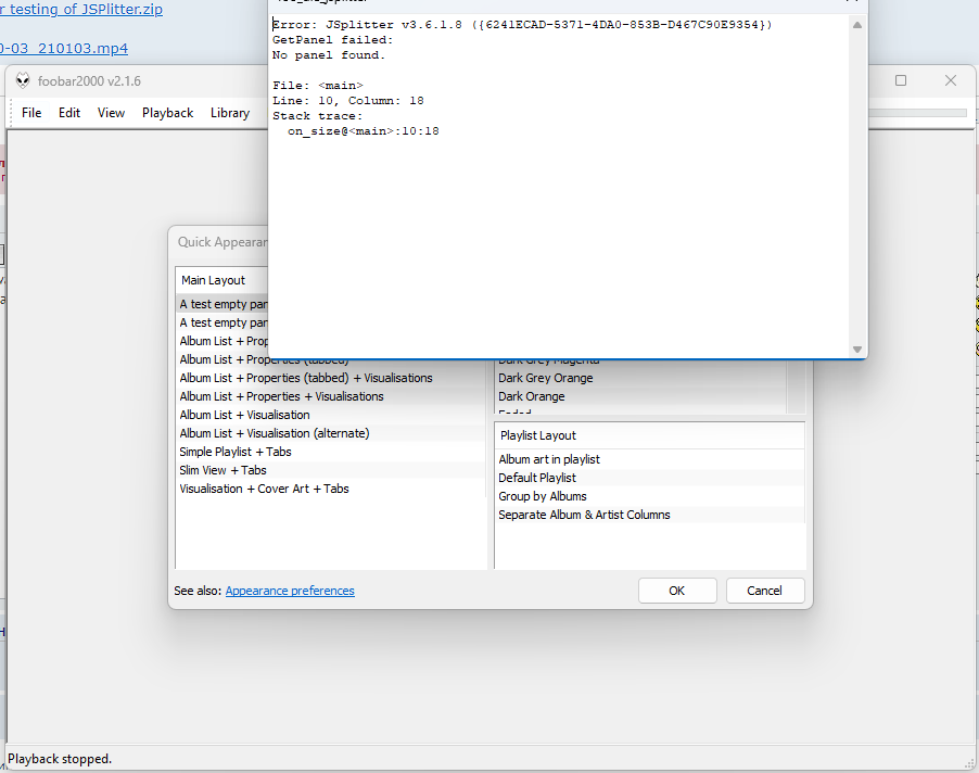

Сообщение #401 LUR » 03.10.2024, 20:16

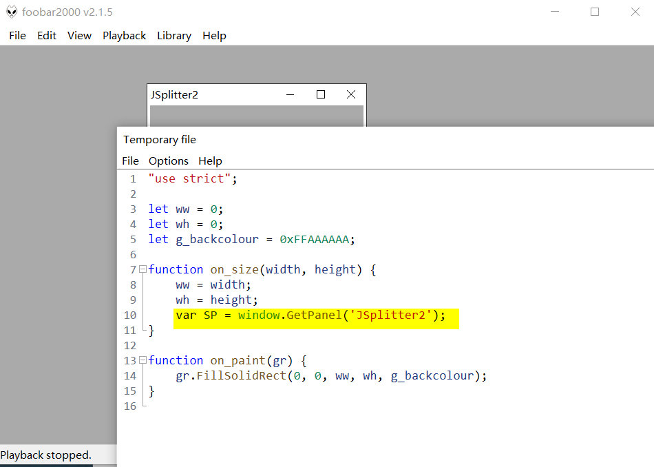

dreamawake:var SP = window.GetPanel('xxxx');
I can't see your panel naming cause I can't import test themes.
Especially if you just put your test them in a profile with a name theme.fth, they are just empty without any panels
What is xxxx ? If no panel with this name you'll get this error.
Добавлено спустя 6 минут 56 секунд:

Сообщение #402 dreamawake » 03.10.2024, 20:36

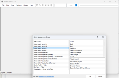

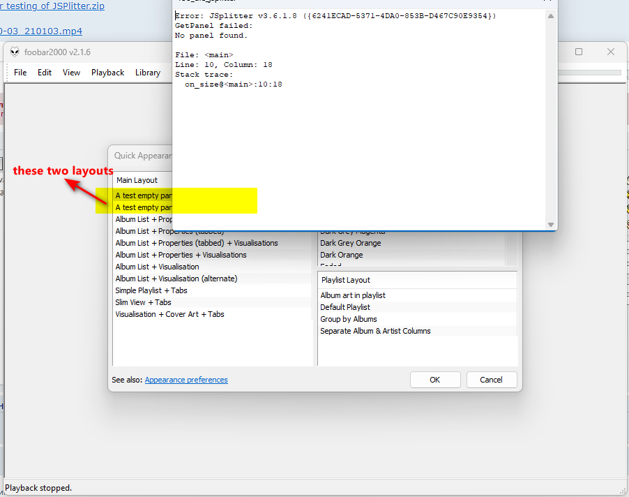

Layouts already in your Quick Setup lists, see highlighted below.

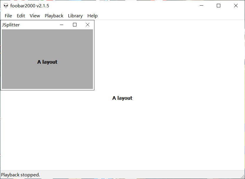

Both two layouts have two splitter panels -- one parent one child.
xxx stand for the child panel name in the layout, one layout is "JSPlitter", another layout is "JSPlitter2". The names are in accordance with the panels.

Сообщение #403 LUR » 03.10.2024, 20:41
When changing the main layout, the old script tries to execute one else, and only then the new JSplitter settings from another theme are loaded, including the script. If you do Reload, everything is fine. I have to think if I can fix this (although it's not a critical bug). In Columns UI this doesn't happen when importing a theme.

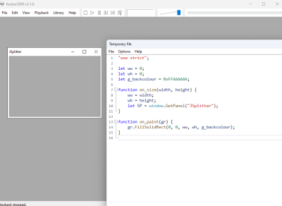

Сообщение #404 dreamawake » 04.10.2024, 19:33
Hi, LUR, thanks for your update. Glad that crash will not occur upon switch, but the problem is settled 50% only, because the elements of the origin layout and the new loaded layout are not swapped properly, they will "mixed" together and causing crash for further operation.
I attached two new simple layouts (A & B) with different appearance for your testing, please look at it and you will catch the "mixing".
test themes A&B.zip
Thank u again.

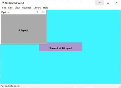

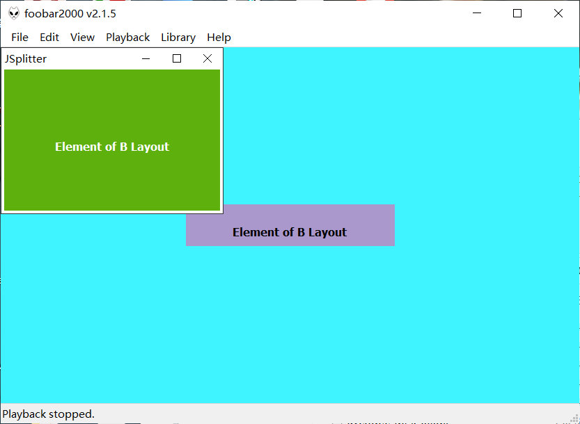

Сообщение #406 dreamawake » 04.10.2024, 19:53
These two layouts are as below. I have confirmed again. Please see if you need to be restart foobar2000 upon switch (this is the exact problem).
A layout:
B layout:
mixed upon switch:

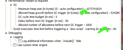

And please, the limit of 60s on the slow script warning. Allowing a 0 or -1 to disable it and much higher values too. This one alone has provoked a lot of script reports when tagging huge libraries on batch using scripts and similar things.
Both preferences are hard limited to those values, and you can not increase it (or disable the second one).
Thank you so much.
