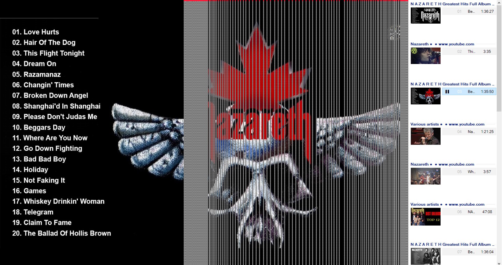

Hi LUR, the 3.6.1.5_x64 version, seems to have compatibility issues with the script panel under SMP-samples, such as running slowly, popping up error dialogs, displaying as a blank panel, etc., is there any room for improvement?
Добавлено спустя 3 часа 49 минут:
Attached is a crash report!
failure_00000001.rar

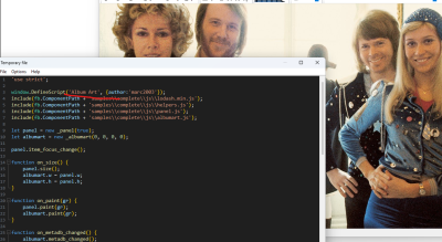

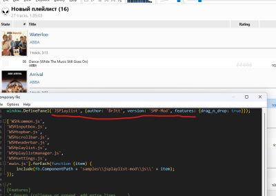

Сообщение #378 LUR » 06.05.2024, 18:17
yeyo:the 3.6.1.5_x64 version, seems to have compatibility issues with the script panel under SMP-samples, such as running slowly, popping up error dialogs, displaying as a blank panel, etc.
I don't know what are you talking about...
Добавлено спустя 15 минут 13 секунд:
yeyo, check component integrity, reinstall it and reset foobar2000 settings, I can't help you with anything else =)
