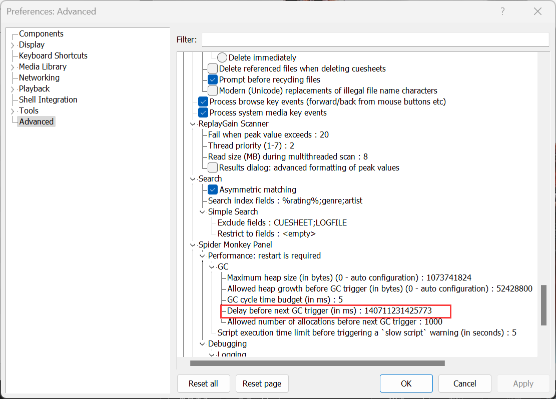

Сообщение #382 yeyo » 11.05.2024, 06:44
LUR:Версия 3.6.1.6 [10.05.2024]
x64:
Glad to see that the x64 issue regarding JS is resolved, after testing, there are no bugs reported regarding JS.
but there seems to be a memory leak and the memory keeps growing during playback, as does the value of the GDI object.(When the foobar2000 window is the active window)

Сообщение #384 yeyo » 11.05.2024, 08:21
LUR:how did you determine that? OK, I started the player, measured the amount of memory and I'm going to go to bed now, I'll wake up and see how much I've used
Good night!
When the foobar2000 window is the active window, I loaded a few panels like jsplaylist-mod under foo_uie_jsplitter\samples here, and the memory can go up by 1GB+ for about 20 minutes of playback, and if the playback time is longer, it may just fill up the amount of memory.
I found the reason why the memory and GDI object values ​​continue to grow. Why are the values ​​​​here so huge? I have never made any settings here. After changing it to 1000, everything became normal.
LUR:I haven't figured out how to reproduce the bug at all. please explain further
I'm sorry! This problem is caused by my translation problem and has been eliminated. You do not need to test again.
Добавлено спустя 4 часа 58 минут:
yeyo:changing it to 1000, everything became normal.
clerical error,changing it to 50, everything became normal.

yeyo:Why are the values ​​​​here so huge? I have never made any settings here.
That's weird. The default value of “Delay before next GC trigger (in ms)” is 50 and cannot be more than 500. This could only happen if the player crashed and the settings were written to disk incorrectly
Репутация: 408
Сообщение #386 yeyo » 11.05.2024, 14:36
LUR:That's weird. The default value of “Delay before next GC trigger (in ms)” is 50 and cannot be more than 500. This could only happen if the player crashed and the settings were written to disk incorrectly
Yes, I set this value again. The maximum value is only 500. I don’t know where that value came from. It works very well now. Thanks again!

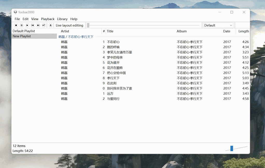

Сообщение #392 yeyo » 20.05.2024, 14:36
I have the same crash in the English version, under the CUI user interface, in the editor window, click on any of the "Options-Presets" in the menu bar, and it crashes immediately, without this problem under the DUI user interface
