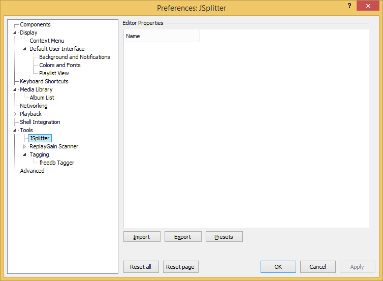

Сообщение #227 marc2003 » 05.12.2019, 09:07
File>Preferences>Tools>JSplitter is buggy. It's blank when you open it but when you click the white area, list items appear.
But if you switch to another Preference node and then back to JSplitter, all items appear normally.
marc2003
С нами: 7 лет 1 месяц
Сообщение #228 LUR » 06.12.2019, 00:44
marc2003, thanx for reporting. I use CUI and have no chance to catch this bug))
